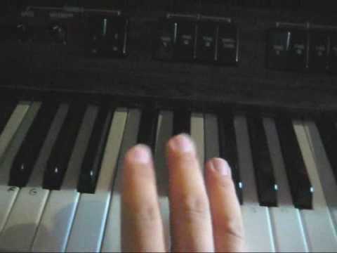

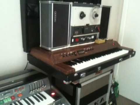

Hi, I just wanted to share with you a service I did myself to my Yamaha cp-30 electronic piano. It's from 1976, and works with hammer systems, just like a real piano, but hits sensors instead of strings. I bought it some months ago, and it needed a cleaning service. I tried to take it to a good technician, but, also very expensive, he had a lot of work in his hands (maybe). So, wtf, I'm technician, and I know how to work with electronics and equipment, so I dedicated time and love and did the work. It was a great experience, and I have to recognize that electronic instruments nowadays are almost plastic shit when speaking of their construction (they sound great in many cases). I took some pics of the process and uploaded some of them in my album here at MS. Maybe some of you are interested, or just curious, but I know that some musicians here have good synths and would like this:
